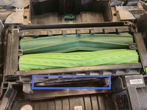

+[title] Remove the Cleaning Head Module
+[* red] Unscrew all 4 screws highlighted in red using your PH1 size screwdriver.
+[* icon_caution] ***IMPORTANT*** Do not try to remove the screws. Just unscrew them until they are no longer biting any threads. When you remove the module, the screws will stay with the module.
+[* black] After all screws are removed, gently lift the cleaning module by inserting your fingers into the slit highlighted in blue and lifting straight up.
