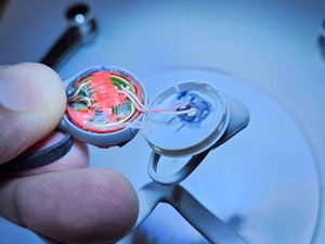

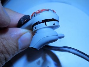

+[title] Earpiece removal
+[* black] With the button cover removed, you can run a dull knife down through the sides to free up the glue holding the earpiece to the main housing.
+[* black] Apply gentle pressure to pull the earpiece away. Be careful to not rip the very short speaker wires.
