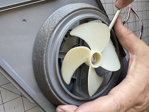

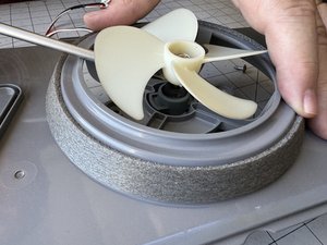

+[title] Remove the fan blades from the fan motor shaft
+[* black] Use a 1/4" flathead screwdriver to pry off the fan blades from the fan motor shaft.
+[* icon_note] They are just held in place by a friction fit and will slide straight off. Try to pry as close to the fan shaft as possible; avoid prying on the fan blades.
