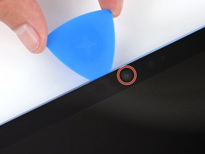

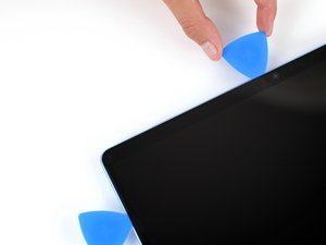

+[title] Separate the top edge adhesive
+[* icon_caution] Remember not to insert your pick more than ***8 mm*** on the top edge.
+[* black] Slide the pick along the top edge and stop before you get to the front facing camera.
