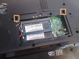

+[* red] Unscrew the screw with a Phillips Head #00
+[* orange] Two clips are located at the top. Dissengage them and lift the panel.
+[* icon_note] A spudger can be used, but is not required.
