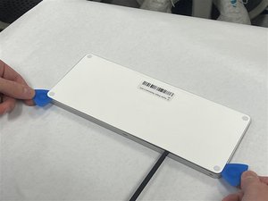

+[* black] Apply heat around the perimeter of the lower case to loosen the adhesive that secures the lower case to the chassis.
+ [* icon_note] The plastic should be a bit too warm to touch comfortably, but not hot.
+[* black] Insert an opening pick in the gap between the lower case and chassis.
+[* black] After ensuring that the adhesive is warm, slide the pick around the perimeter to sever the adhesive.

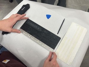

+[* black] As you sever the adhesive, insert additional opening picks at each corner to prevent the adhesive from readhering.
+[* black] Remove the lower case.
