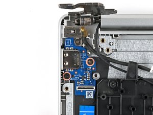

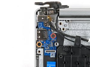

+[title] Remove USB board screws
+[* black] Use a Phillips screwdriver to remove two screws.
+ [* red] One 3.1 mm‑long screw
+ [* orange] One 4.3 mm‑long screw
