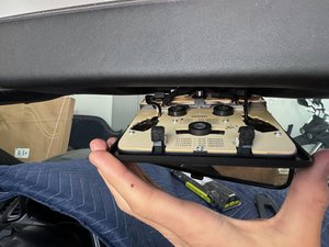

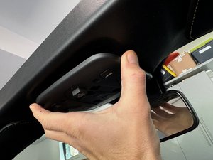

+[title] Detach Center Controls
+[* black] Remove the 3 torx 15 bolts.
+[* black] Gently pull on the enclosure to detach it from the frame.
