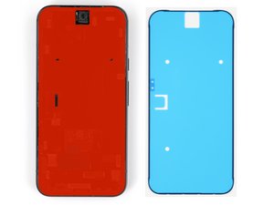

+[* icon_note] If your screen already comes with adhesive pre-installed, remove its liner and [guide|173219|SKIP DOWN FIVE STEPS|stepid=342110] to continue reassembly.
+[* black] Before removing any liners from the screen adhesive, hold it over the frame to make sure it's oriented correctly. Use the camera cutout on the top edge to line it up correctly.
+ [* icon_note] The blue liner should be facing up, with the larger, clear liner on the bottom.
