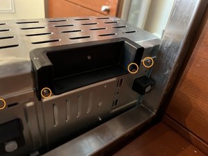

+[* black] • Remove the right side cover by unscrewing the four screws on the top of the cover (set safely aside) and
+[* black] the four screws of the bottom cover (set safely aside) Note that the top screws are different than the bottom ones.
+[* black] • Once the 8 screws are removed you can easily remove the right side cover. (the sheet metal edges can be sharp - be careful)
