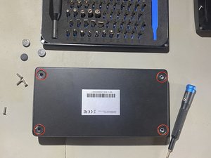

+[title] Removing bottom cover
+[* black] Remove the 4 rubber feet
+[* black] Using a TORX TR8 remove the bottom 4 screws
+[* black] Using a spudger be very gentle when prying as the mainboard is right under it.
