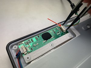

+[* blue] Remove kickplate
+[* green] Locate motherboard
+[* red] Remove the COM2 connection from housing with a set of needle nose pliers carefully.
+[* icon_caution] Use extreme caution when removing to mitigate damage the motherboard.
+[* icon_caution] Do not pull by the wires, only by the plastic housing.
+[* icon_reminder] Ensure the motherboard is secure to prevent damage when installing new cable.
