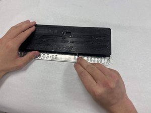

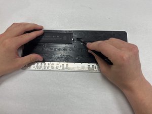

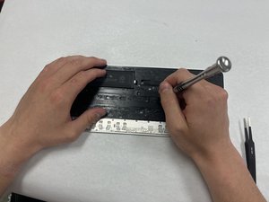

+[* black] Using a T3 size screwdriver head, take out all twelve of the screws that 3/16 inches long that are fixing the plastic in place. Then use a tool to pull up on the connection between the battery and the motherboard. After having done both of these steps, start pulling up on the inner plastic to pull it out safely and slowly.
