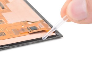

+[* black] Use tweezers or the flat end of a spudger to peel up and remove large pieces of old adhesive from the screen.
+[* black] Apply one or two drops of highly-concentrated isopropyl alcohol (over 90%) to any residual adhesive.
+ [* icon_caution] Only apply one or two drops at a time, and don't spill any on the screen panel itself to avoid damaging it.
+[* black] Use a lint-free or microfiber cloth to wipe the perimeter of the screen clean.
