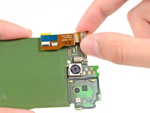

+[* black] Use the flat end of a spudger to free the interconnect cable connector.
+[* black] Remove the interconnect cable from the motherboard.
