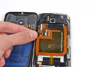

+[* black] Use the tip of a spudger to flip up the retaining flap on the flash cable ZIF connector.
+[* icon_caution] Be sure to pry only on the flap itself, ***not*** on the connector.
+[* black] Pull the flash cable straight out of its socket.
