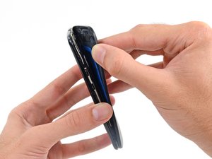

+[* black] Carefully peel the back cover off of the phone.
+[* icon_note] The back cover is very flexible, but you don't want to damage any internal components by being too hasty.
+[* icon_caution] Do not separate the back cover entirely as it is still connected to the phone by the camera flash cable.
