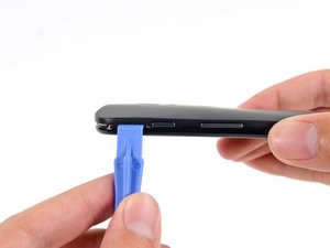

+[* black] Carefully slide the opening tool along the button side of the phone.
+[* icon_caution] The plastic on the front cover is thinner here and the buttons may move around, go slowly to avoid damaging either the buttons or the front cover.
