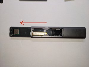

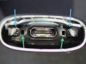

+[* black] To remove the inner plastic sled containing the actual remote, remove the following screws:
+ [* orange] 2 very small screws at the top.
+ [* light_blue] 2 screws where you just removed the USB dongle recepticle.
+ [* green] Remember the two plastic pieces that fell out? This is where you later have to place them again
+[* red] When you removed these 4 screws, you are able to slide the inner sled out of the top of the housing.
