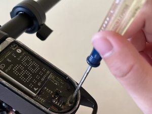

+[* black] Place the dashboard back on top of the wire connections.
+[* black] Take the 3 screws you store away previously and screw it back to the proper locations using the 3mm Philips screwdriver.

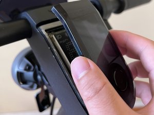

+[* black] Cover up the dashboard with the display you pry open on step 1. To ensure the seal is flushed, you may add sugar glue to the crease.
