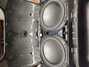

+ | [title] Remove the Mesh Cover - Front |
+ | [* green] Using your opening tool, pry into the front of the mesh cover where indicated to release the two catches. |
+ | [* black] When both catches are released, the front cover should hinge completely backwards and be completely open. |
+ | [* icon_note] When reassembling, make sure these catches line up properly. Attempting to force them closed if not lined up properly can result in breakage and a loose mesh cover. |
+ | [* black] With both the back and front released, the mesh cover should easily lift away. |
+ | [* light_blue] When reassembling, make sure these posts line up properly, as well. These posts are only on the front and ensure the mesh cover does not physically touch the speakers. |
+ | [* icon_note] Attempting to force them closed if not lined up properly can result in distorted sound or damage to the speakers. |
