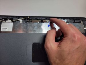

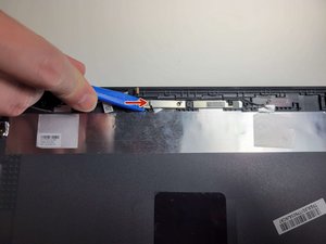

+[* red] Use the iFixit opening tool to remove the webcam board from the from the adhesive carefully that secures it to the display
+[* blue] and lift the webcam board off of its alignment pins.
+[* icon_note] Reverse this procedure to install the webcam board
