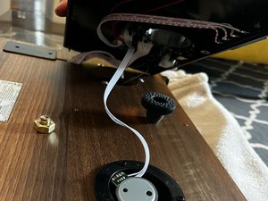

+[title] Remove the main circuit cover
+[* black] Flip over the unit and remove the six screws holding the black plastic cover in place.
+[* black] A #2 Phillips-head bit is recommended for these screws, though a #1 will work if necessary.
