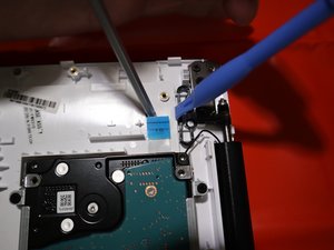

+[* black] Under the I/O board there's a hole that you need to insert a tool and push the keyboard at the same time you pull the plastic as show in the picture. This plastic holds the keyboard.
+[* black] There are more holders, but you just need to open one, the others will sag when you pull the keyboard smoothly
