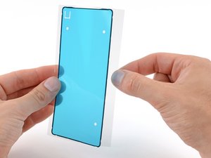

+[* black] Before removing any liners from the screen adhesive, hold it over the frame to orient it.
+ [* black] Make sure the blue adhesive liner is facing up and the tab cutout is to the left of the front-facing camera.
+[* black] Start peeling off the right edge of the large adhesive liner. Don't fully remove it, yet.
