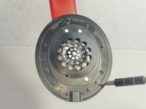

+[* red] Using a Phillips #0 screwdriver remove 7 3.6 mm screws holding the speaker assembly in place.
+[* icon_note] Make sure the screws aren't close to the speaker; due to it being a magnet, the screws could get stuck and damage the speaker
+[* black] Open the speaker by pulling the top layer of the speaker
