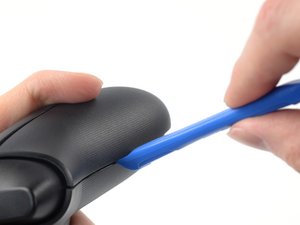

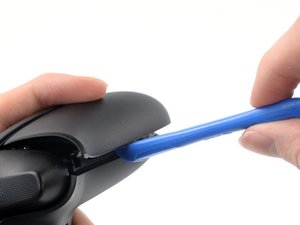

+[title] Pry up the left handle cover
+[* icon_note] The right edge of the left handle cover is held in place by strong clips.
+[* black] Position the opening tool in the middle of the left handle cover.
+[* black] Pry up the left handle cover to release the clips securing the right edge of the left handle cover.
