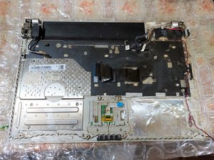

+ | [title] The insides. |
+ | [* black] Unscrew the heatsink and fan assembly. Disconnect the fan and remove it. |
+ | [* black] Remove the screws that hold the motherboard in place |
+ | [* black] Disconnect the touchpad, keyboard, USB module and Wi-Fi module. |
+ | [* black] Disconnect the power, screen and speaker connectors. |
+ | [* black] Unscrew the hinges and remove the display. |
+ | [* black] Remove the motherboard. |
