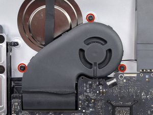

+[* red] Remove three 12.4 mm T10 screws securing the fan to the rear case.
