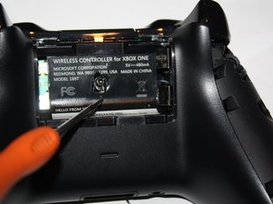

+[* black] Using a TR9 Torx screwdriver, remove the top and bottom screw of each handle and the one screw within the battery area (five screws total).
+[* black] Note: You will have to remove the warranty sticker or puncture it to reach the battery-area screw.
+[* black] Remove the front and back plate of the controller by pulling them apart.
