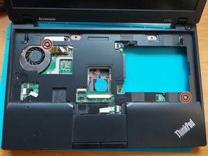

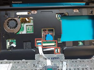

+[* black] Carefully lift up the keyboard and unplug it and the touchpad.
+[* black] Remove the 2 screws that hold the panel in place.
