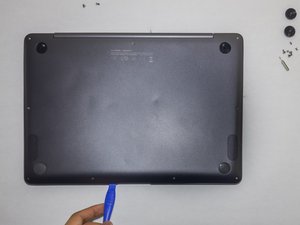

+[* black] Use the plastic spudger to gently pry the bottom case away from the laptop chassis.
+ [* icon_note] The bottom case is connected to the upper case with 4 plastic clips near the edges of the laptop.
+[* black] Gently pull the lower case away from the upper case of the laptop by lifting the top first.
