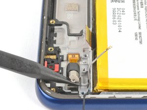

+[title] Reposition the vibration motor
+[* black] Insert the point of your spudger between the motor counterweight and the frame.

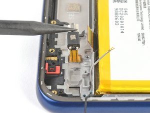

+[* black] Pry the motor out of its recess and flip it over.
