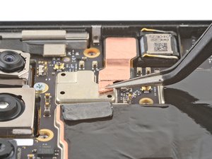

+[title] Peel the copper tape
+[* black] Use the tips of your tweezers to lift a corner of the front-facing cameras copper tape.
+[* black] Grab and peel the copper tape from the motherboard.
+ [* icon_note] This tape tears very easily. Work slowly and apply more heat if the tape feels stuck.
