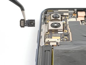

+[title] Remove the depth camera
+[* black] Use the point of a spudger to pry and disconnect the depth camera's press connector.
+ [* icon_note] The camera may eject from the motherboard. Work slowly to avoid losing it.
+[* black] Grab and remove the camera.
