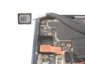

+[title] Reassembly information
+[* icon_reminder] If the earpiece speaker's mesh isn't in the frame, transfer it from your old frame or speaker. Do not install the speaker without this mesh.
+[* icon_reminder] During reassembly, orient the speaker so the raised sides of the connectors are closest to the front-facing camera.
