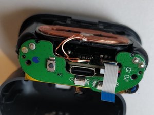

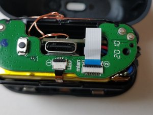

+[title] Remove connections of the bottom circuit
+[* black] Lift the black plates and remove the connection to the LED (small one with black end) and the connection to the main circuit (big one with blue end) using tweezers
