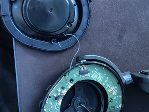

+[* black] With the cup off, now you need a Torx TR6 bit to remove three screws. This is relatively easy, but do be careful when removing the lid, as there is a wire connecting it to the pcb housed in the body.
