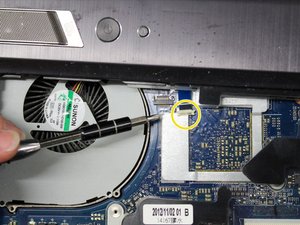

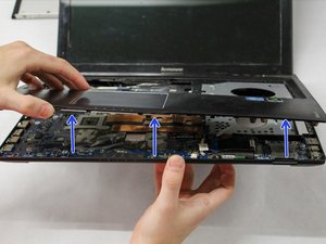

+[* black] Lift open the top panel carefully as there are wire cables secured to the motherboard.
+[* black] After locating the cable holding the top panel in place, carefully unhook the handle using precision tweezers.
+[* black] Carefully remove the top plate.
