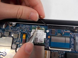

+[* black] With J1 phillips head bit, unscrew the single screw that secures the card to the board.
+[* black] Disconnect the two wires connecting to the card. Note: Be sure to remember which wire is which. It is easy to get these wires mixed up.

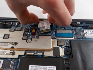

+[* black] Lift the card slightly and then pull away from the port and remove.
