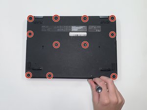

+[* black] Flip the Chromebook face down.
+[* red] Then unscrew the 12 screws using a size 0 phillips head screwdriver. The screws in this step are 5 mm long.
