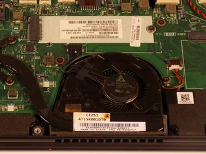

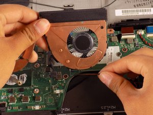

+[* icon_caution] The fan is not ready to be removed yet. When lifting the fan from the frame, keep it within 2 inches from the motherboard until the attached wire is removed.
+[* black] Lift the fan and heatsink from the motherboard; then flip both toward the motherboard
+[* black] Detach the wire from the perimeter of the fan casing. The fan can be removed after this step.
