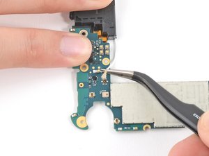

+[title] Disconnect the speaker assembly
+[* icon_note] Follow [guide|25629|this guide|stepid=64972] for in-depth instructions on how to disconnect a coaxial connector.
+[* black] Slide one of the tweezer's tips under the white wire until it's snug against the connector, and pry straight up from the board.
+[* icon_reminder] To reinstall, hold the connectors in place and gently press them straight down. The connectors “snap” into their sockets much like the metal snaps on a jacket.
