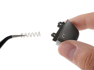

+[title] Remove the trigger
+[* black] Remove the trigger.
+[* icon_note] Take care to not lose the trigger spring. It press-fits onto a peg on the trigger's underside.
