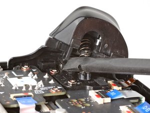

+[title] Unclip the trigger
+[* icon_note] The Steam Deck's triggers clip into place on two pegs, which double as hinge points.
+[* black] Position the flat end of a spudger on the inside edge of the trigger's left clip.
+[* black] Push the trigger out and away from the peg to unlatch it.
