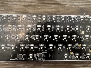

+[title] Resoldering
+[* black] Resolder the switchback onto the PCB by carefully heating the metal rings on the PCB and applying the solder wire onto the heated surface.
+[* black] Apply solder to the switch pin until a small mound conceals the pin resembling the factory solder job on the board.
+[* black] Try to be conservative with the amount of solder that is used. Less is more!
