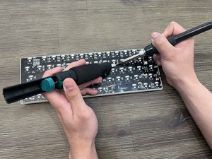

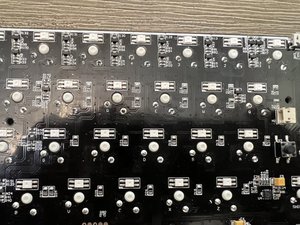

+[* black] Using the labels on the back of the PCB locate your faulty switch.
+[* black] Begin desoldering by carefully applying the hot iron onto the two solder joints surrounding the key label.
+[* black] Use the solder pump when the solder visibly melts. Continue this process until the switch pins are visibly unsoldered from the PCB.
