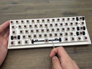

+[* black] With the screwdriver, carefully pry the keyboard plate out of the case from the spacebar gap located at the bottom of the plate.
