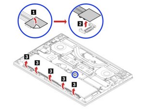

+[title] Unplug the battery
+[* blue] Peel up the insulated sheet from the battery connector.
+[* blue] Unplug the battery connector in the direction showed by the arrow.
