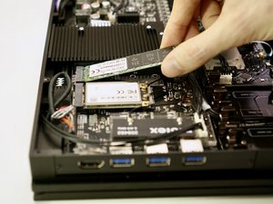

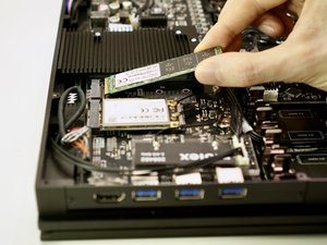

+[title] Remove SSD
+[* black] Lift the free end of the SSD up slightly and pull the SSD straight out of its M.2 socket on the motherboard.
+[* icon_caution] To avoid damaging its socket on the motherboard, do not excessively lift the free end of the SSD.
